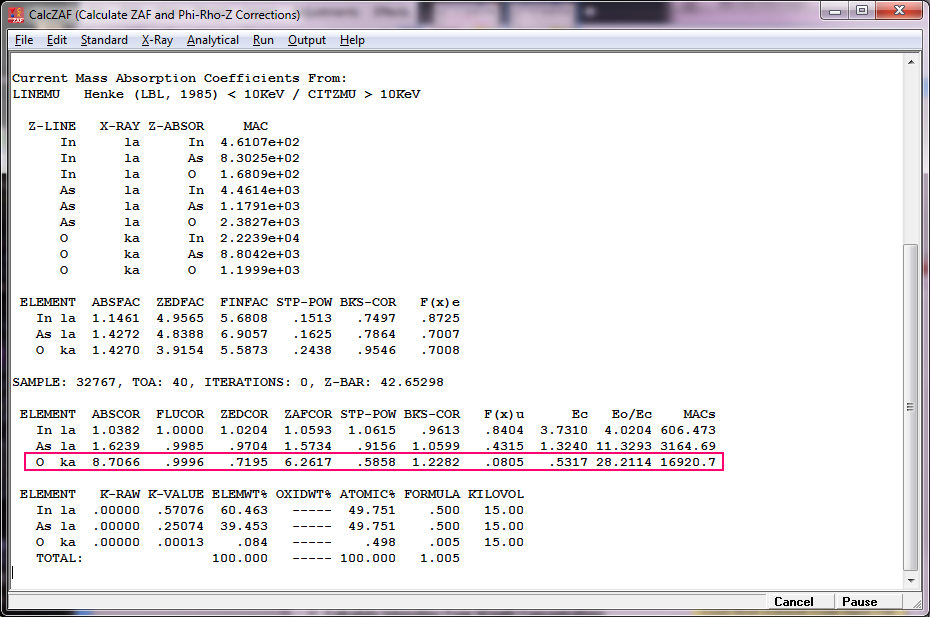

Is this in reference to measuring O ka as an emitter?  Please take a look at the mass absorption coefficients for oxygen absorbed by other elements.  CalcZAF has a very nice output for this:
Notice how the MACs increase until just after In and Sn as absorbers.  Then it drops off. That is called an absorption edge. If you would like to learn more I suggest Goldstein et al., 1992.

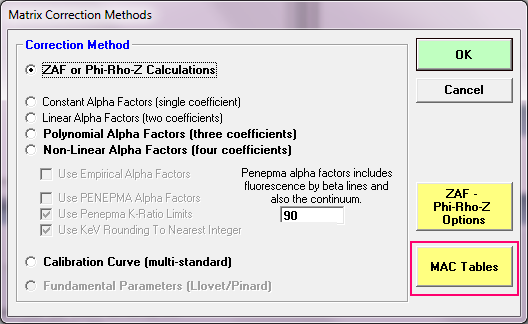

One way to evaluate the matrix corrections is to utilize the Use All Matrix Corrections checkbox in the Analyze! window in Probe for EPMA.

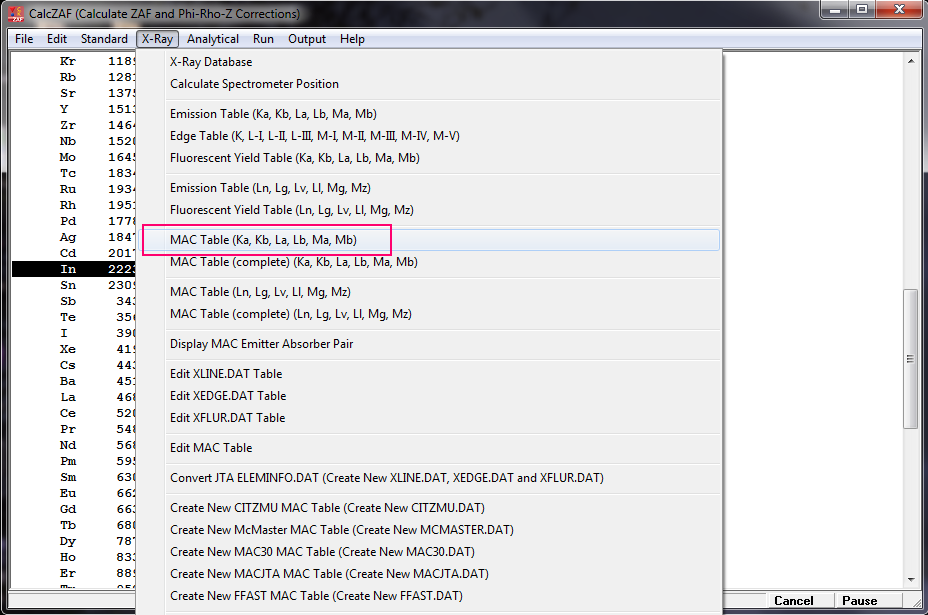

One can select the various MAC tables from the Analytical | ZAF, Phi-Rho-Z, Alpha Factor, Calibration Curve Selections menu as seen here:
One can also try various MAC tabulations from the literature as described here:
https://probesoftware.com/smf/index.php?topic=1340.msg9631#msg9631

Because the mass absorption coefficients are already normalized to mass, you can simply sum the mass fractions of each element's MAC to obtain the average MAC (actually we should be using attenuation coefficients and molar concentrations as is done in PENEPMA!).

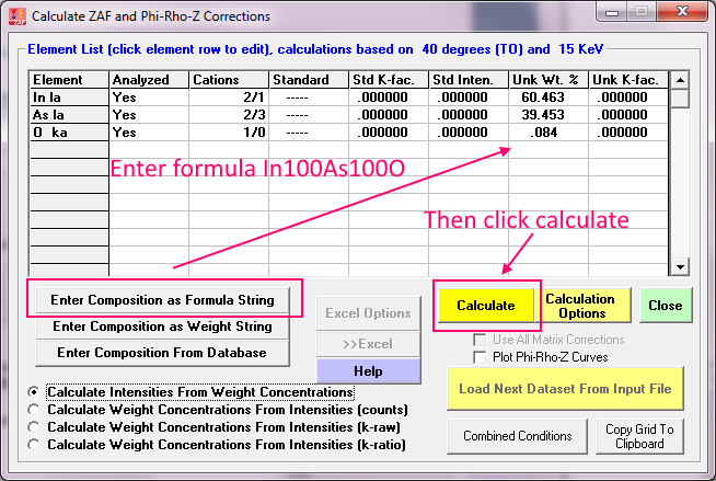

But you can do this easily in the CalcZAF application by simply entering the compound (by formula or weight %) with a small amount of the emitting element, and calculating the k-ratios.
Here is an example of InAs with a small amount of oxygen (100 atoms of In, 100 atoms of As and 1 atom of oxygen):
After clicking the Calculate button we obtain this output:

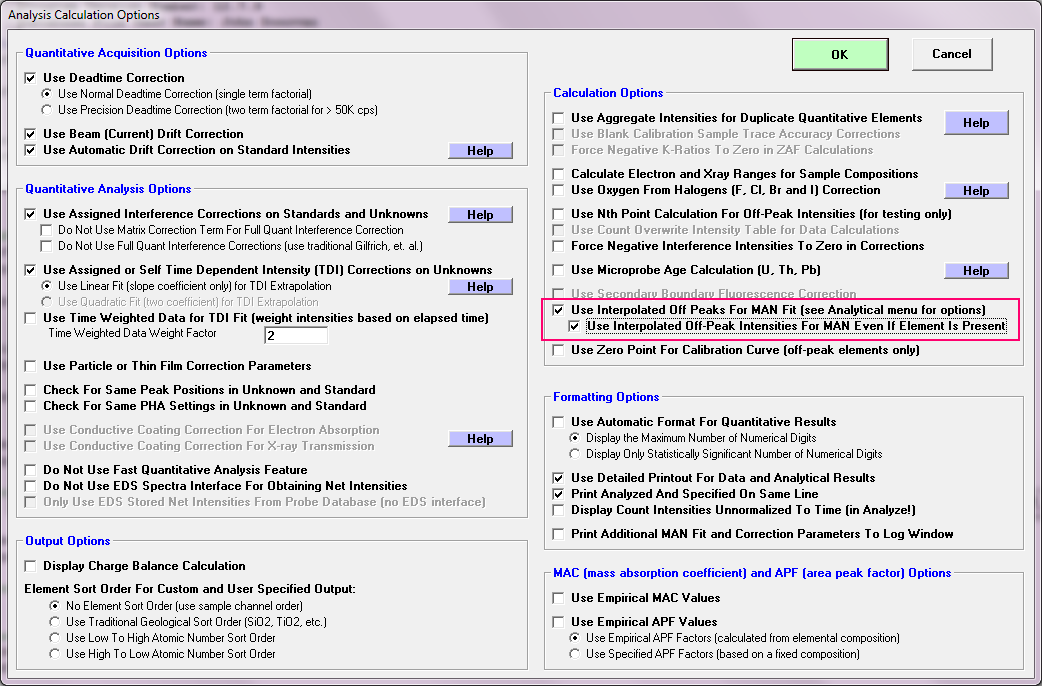

I am not a coder, but from a user perspective it seems like maybe a stern pop-up warning when un-checking the 'use interpolated off peak' might be enough to get the risk across? If that were ignored or didn't exist, as you say as soon as one looked at their 'Assign MAN Fits' hopefully it would be pretty obvious that something was deeply awry. And even if you ignored that, your results should really make introspection unavoidable?
Hi Phil,
OK, I think have something that will work.  What we did was add a new checkbox to the Analysis Options dialog as seen here along with the original Use Interpolated Off-Peaks For MAN Fit checkbox:
This new checkbox is called Use Interpolated Off-Peak Intensities Intensities for MAN Even If Element Is Present.  That's a mouthful but I think it does what it says.  What this new flag does is basically just ignore the MAN minimum intensity level for MAN standard assignments that is set at 100 PPM. Now the cool thing is that this new MAN fit option actually reveals several interesting problems with using off-peak intensities for determining backgrounds (off-peak or MAN!).  Three separate issues actually I think.  These issues have been described in detail by many of our colleagues, Mike Jercinovic and others, Julien Allaz, Karsten Goemann among them I'm pretty sure.  You've probably seen them yourself as well.
This should be also very useful when you want to map for trace elements in a phase that's constant for major elements, allowing a single measured background to be used
Hi Phil,
But why use a only single MAN background?     ;D
Yes, if the phase is exactly constant for major elements, a single MAN standard would work, but why not measure two MAN standards with average Z values just on either side of your unknown phase and at least you'd have a slope in case the unknown average Z changes even a tiny bit...
