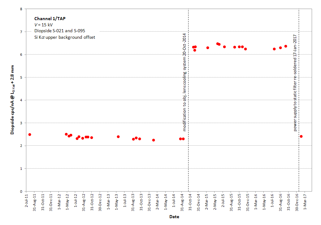

The plot below illustrates background radiation (counts per second per nanoamp) collected at the upper background offset of Si Ka measured using TAP (P-10 gas-flow counter) on either of two diopside standards, one natural (PSU Px-1) and one synthetic (crystalline).  The background offset in every case was located at an L-value 2.8 mm above that of the peak.  Accelerating potential in each case was 15 kV.  Each point on the plot represents an average of 9 or 10 measurements on the standard.
At accelerating potential = 15 kV, a large enough fraction of backscattered electrons has energies appropriate to ionize argon such that these ionizations can contribute significantly to measured background radiation.  The effect is especially pronounced at low Bragg angle, such as for Si Ka diffracted using TAP.  Using the plot below, I can state with some confidence that the period of failure of the static filter -- apparently due to cracking of a cold solder joint at the point of attachment of the power supply to the filter -- was 20 Oct 2014 to 17 Jan 2017.
I had my reservations about the modification to the objective lens cooling system.  It brought to mind an old adage, “If it ain’t broke, don’t try to fix it.”  I guess the solder joint might have failed at some point, but by then (Oct 2014) it had held for 3.5 years.
This just goes to show that monitoring of standard intensities can provide the proverbial "smoking gun" for troubleshooting such issues. PFE users can utilize the Drift application for these purposes as described here:

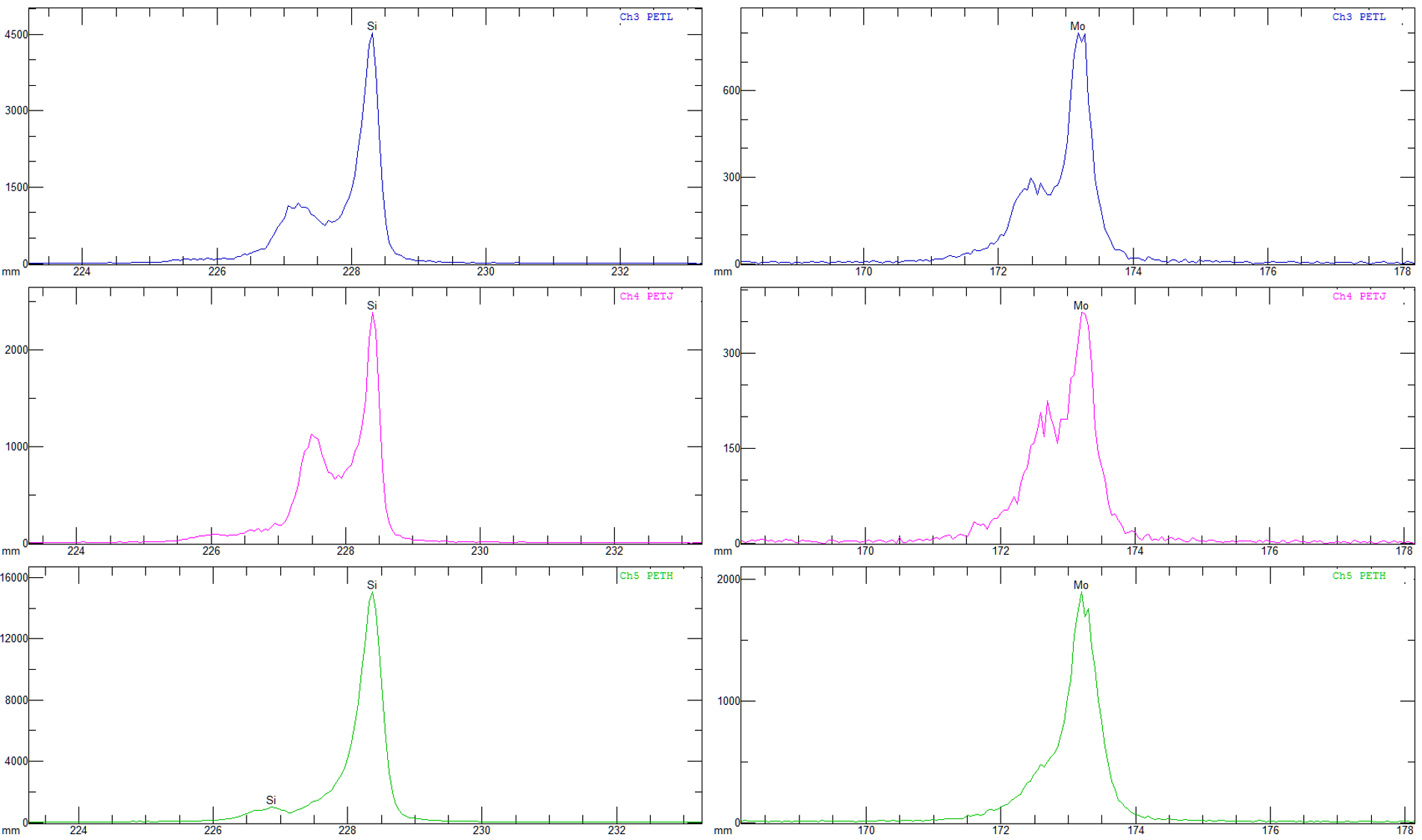

We have the same issue on PETL and PETJ crystals in 8530F.
When the "electrostatic deflector" switch is toggled on/off, we can see the brightness change (but not so largely.)
Was there another reason to cause the peak shape change with PET crystals rather than static filter issue?

And we also see the weird peak shape of Mo with PET crystal, as seen in Si.

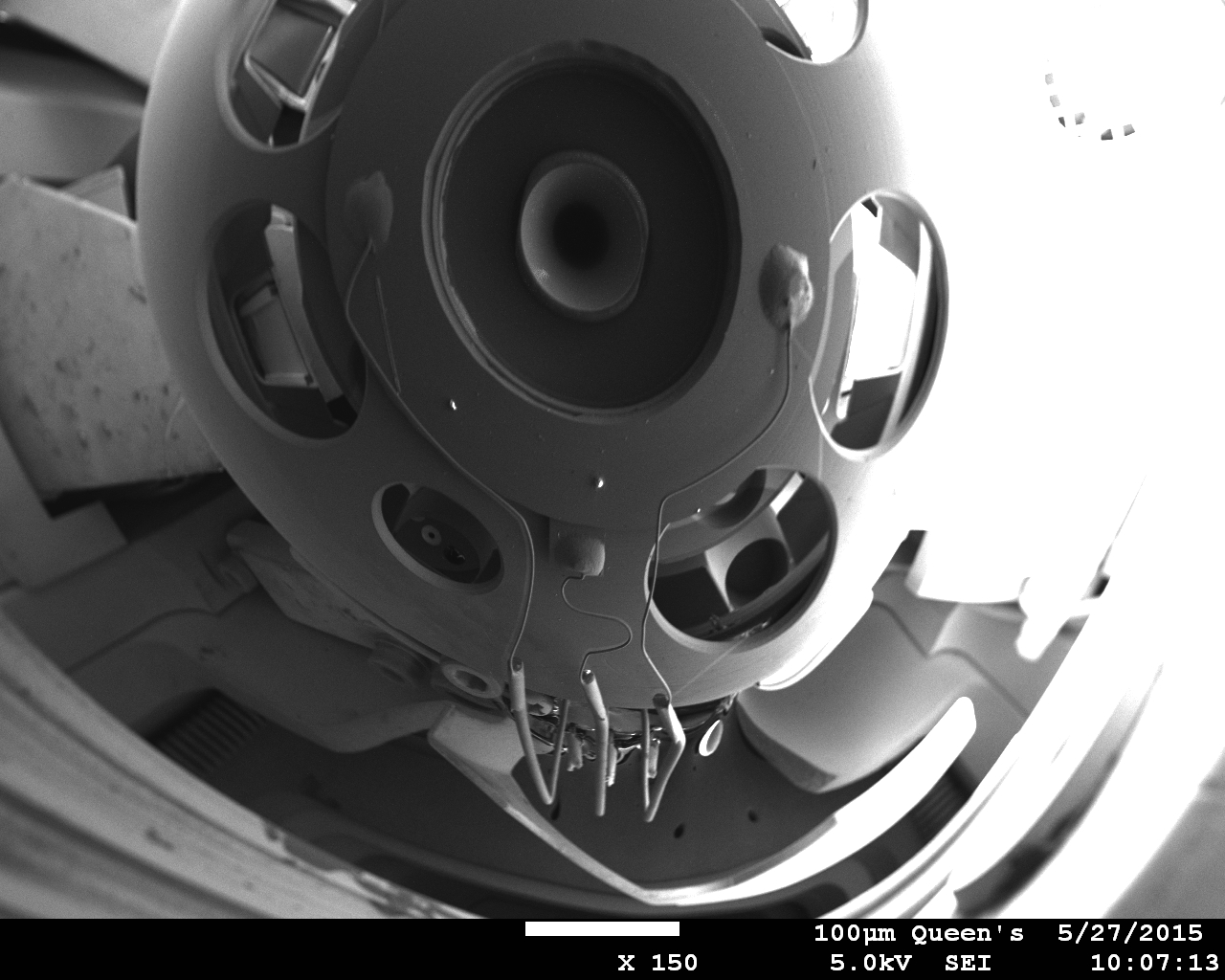

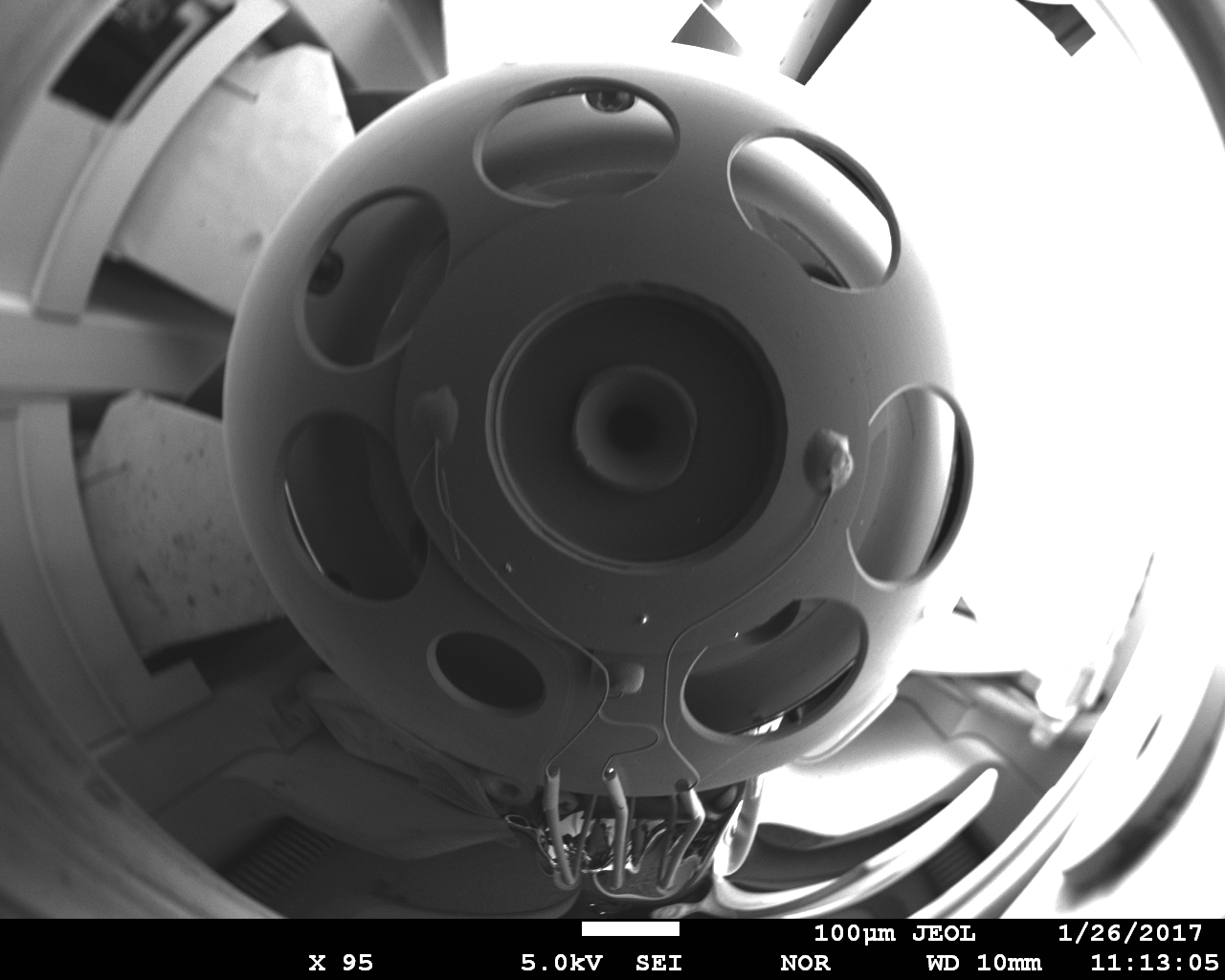

Static filter = electrostatic deflector (four syllables versus eight).  Yes, that change in brightness suggests that it is working.  Also, the fact that PETH does not show the "parasitic peak" suggests that the static filter is not the problem.
If the static filter/electrostatic deflector is off or not working, then you will be able to see inside the spectrometers with the electron mirror.  Note that some of the diffracting crystals are visible in this image:
If the static filter is working properly, then it should appear as if a gray ring is present above the filter:

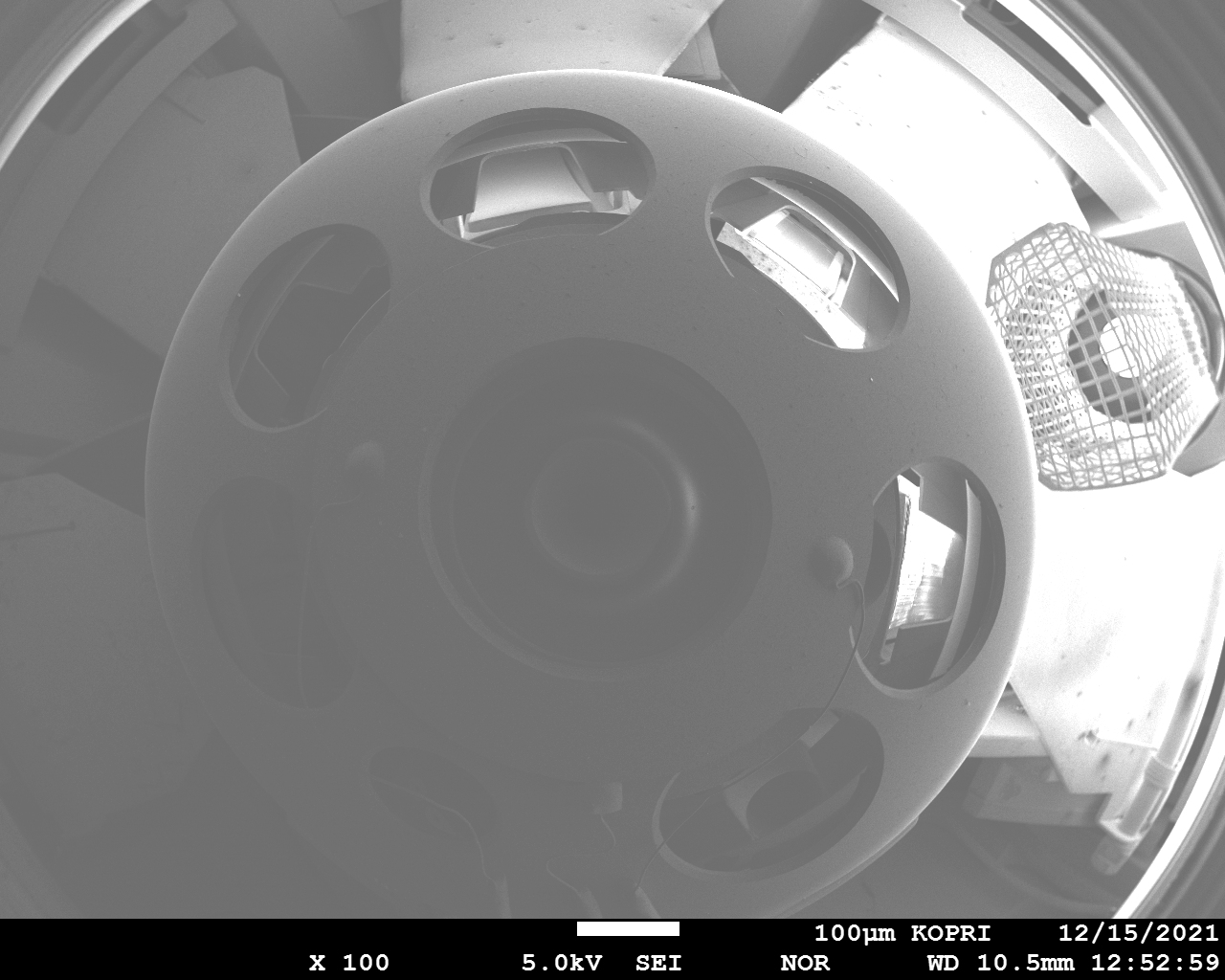

We took electron mirror images when electrostatic deflector turning off and on.
Electrostatic Deflector OFF (You see L-type, normal, H-type crystals from 12 o'clock in clockwise direction.)
Electrostatic Deflector ON
So the problem of our PETJ and PETL crystals is not due to static filter, as Brian said.
