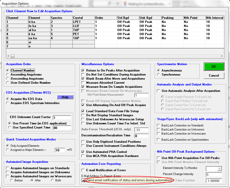

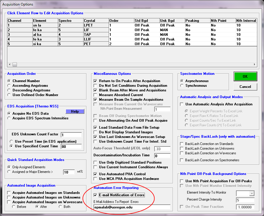

2. The option that an email is send when automation is finished. I have a couple of people sitting in a different building across campus and with the winter as it is here, I am sure they would appreciate this option. Ideally this option would be checked/unchecked in the analysis options rather than acquisition options (or elsewhere), so that I don't need to create a new acquisition sample just for triggering this option.
Also already done!
Simply enter an email address and check this box here in the Acquisition Options dialog from the Acquire! window:
The cool thing about this feature is that it not only informs you if an error has occurred during the automation (e.g., blown filament), but it also sends you a progress report every 8 hours and also sends a final notice email when the automation is complete!   8)
Note that you can optionally set the default address in the Probewin.ini file, but the smtp server and other essentials must be specified in the probewin.ini file as follows:
[general]
SMTPServerAddress="smtp.uoregon.edu"      ; email server address for error messages
SMTPAddressFrom="epmalab@uoregon.edu"
SMTPAddressTo="epmalab@uoregon.edu"
SMTPUsername="epmalab"
The application will prompt you for the password when required. Obviously you will need to enter your own smtp server information in your own Probewin.ini...
How's that sound?
Excellent. I will definitely use that. However I would suggest then to modify the description to remove the word "error" as it is clearly so much more.
Yes you are correct, I will fix that this weekend also. But just FYI you can get additional information on each control by "hovering" the mouse cursor over the control in question, for example see this:

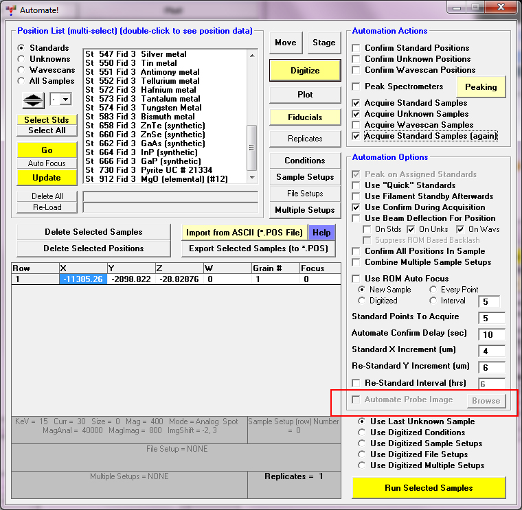

« Reply #41 on: April 05, 2014, 10:17:52 AM »
I would like to see a way of setting up maps in probe image using chain acquisition in the automate window. Is this in the works?
Hi Dan,
It is a good idea and it is "in the works" as you said.  In fact here's the checkbox that you will use to browse to a specific .PrbAcq Probe Image acquisition file and this will get run after the point analyses and standards have finished.

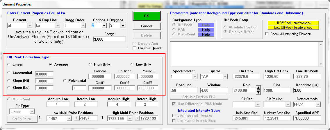

Basically, I have now run into a couple of situations where, after acquiring a bunch of data with off-peak backgrounds, there have a been a few elements where an MAN background would likely have been more suitable, but for several other elements, the off-peak backgrounds were fine. Possibly showing my ignorance of how the MAN backgrounds actually work, but it would be hugely helpful to be able to apply the MAN correction to just a few select off-peak elements in post-processing rather than the whole set.
Hi Owen,
Sorry, but not at this time. Other than first specifying which elements are off-peak and which are MAN (or just making all off-peaks corrected using MAN as you described above), your choices for post processing are limited to one of the many off-peak options as seen here:
I assume by "a few elements where an MAN background would likely have been more suitable" that you mean that there was an unexpected off-peak interference?
Of course one may find an unexpected off-peak background interference occasionally, but generally an initial spectrometer wavescan (after all elements have been peaked properly), run on a suitable sample, will reveal most off-peak interferences as discussed in this post:
http://probesoftware.com/smf/index.php?topic=30.msg271#msg271
It is nice that PFE allows one to automatically acquire a wavescan for all element "regions of interest" with a single acquisition even if one has 15 or 20 or more elements in the run.
If you still get an off-peak interference you can try using the "Low Only" or "High Only" off-peak backgrounds, which essentially ignores the offending off-peak intensity. If the slope is large and a single off-peak won't suffice, then try either the "Slope Low" or "Slope High" off peak background options.
Ideally perform these background fit evaluations using the wavescan sample as described here:
http://probesoftware.com/smf/index.php?topic=68.msg246#msg246
Another possibility that you might find very powerful is the "multi-point" background which allows the application to acquire multiple background mesurements on each side of the peak as described here:
http://probesoftware.com/smf/index.php?topic=56.0
Note that the multi-point off-peaks can also be treated as normal off-peaks in post processing...
