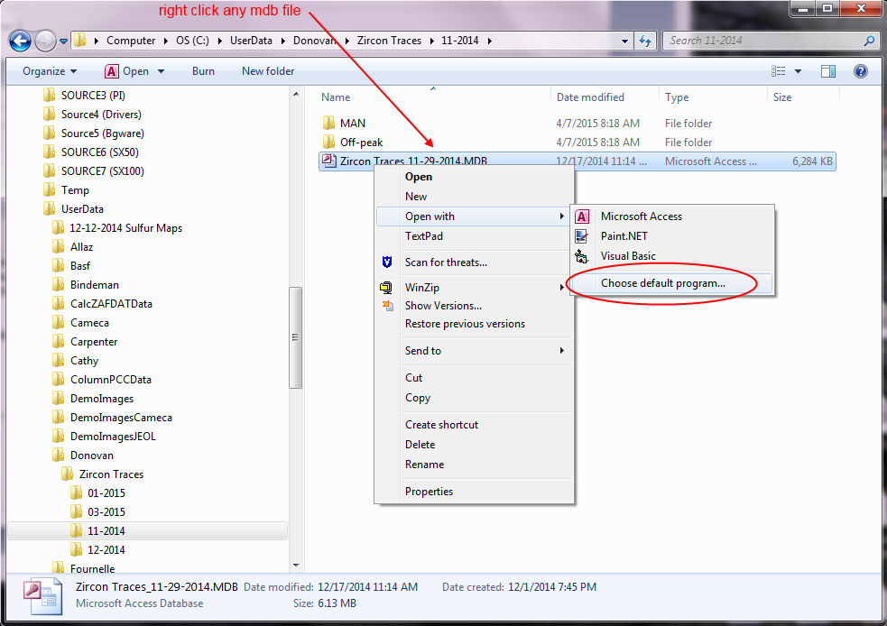

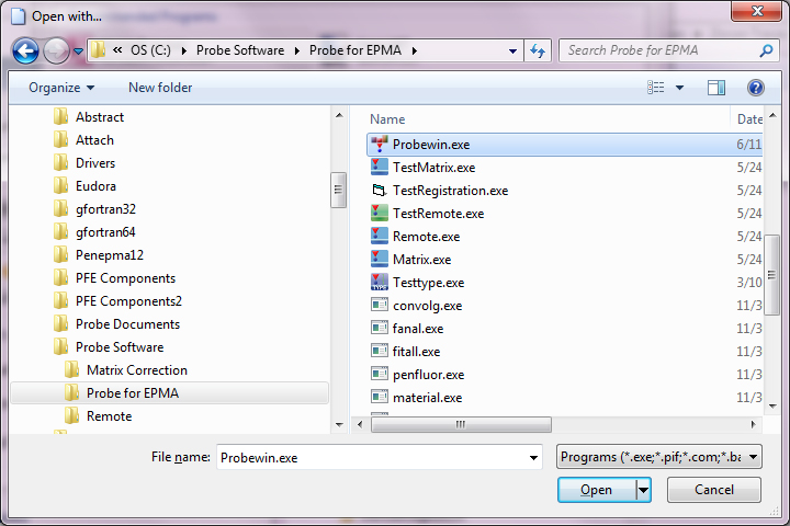

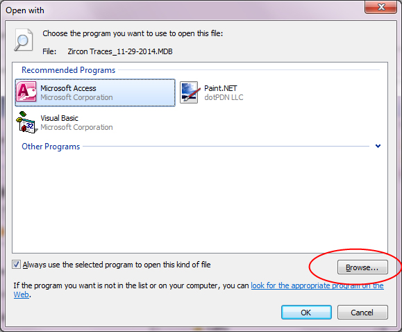

I actually followed the more logical route and dragged and dropped the mdb onto open PfEPMA. That doesn't work.......... it would not have dawned on me to try it any other way. I treated as I would surfer......... or word........
Actually I think Gareth is correct- the most logical action is to double click the file to open it.
You can set that from the right click menu as seen here:
Then click the Choose Default Program... option and then Browse button as seen here:
and browse to the Probewin.exe file and click Open and OK as seen here:
You only need to do this once. Note the MDB file icon now shows the PFE icon instead of Microsoft Access icon in Windows Explorer.

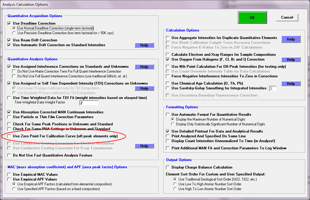

Hi Ben,
Yes, several steel companies use our calibration curve method (in PFE) and it does work, but one does have to be careful. And one needs several standards with a good matrix match and covering a range of concentrations for the element of interest. And one needs "fresh" carbon in steel standards as well, since carbon-steel standards slowly degrade over about 3 to 5 years.
As for the zero point option, that is already in PFE in the Analytical | Analysis Options as seen here:
I'm sure you are aware that due to the native hydrocarbon and contamination effects, a zero concentration might not correspond to a zero intensity (and of course it goes without saying that this zero point option can only be applied to off-peak elements).
