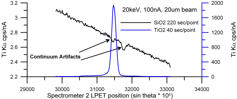

It was also interesting that they did not observe a "hole" in the continuum on their PETJ crystal (note also the unfortunate typo on page 2 where they mention Ti Ka TAP), and since the presence of this continuum artifact may depend on the mounting orientation of the PET crystal during manufacturing, they may have gotten lucky. However I suspect this was because they did not acquire a sensitive enough wavelength scan. They utilized only 5 sec per point in fig 2, but we utilized 300 sec per point as seen here:
It would be interesting obtain additional high precision Ti Ka PET scans from other labs to see how often this hole in the continuum appears. I note that the hole is visible in both of my LPET crystals, but not in any of the normal sized PET crystals.  Could this artifact be related to Bragg crystal size?  Can anyone share additional observations on this question?

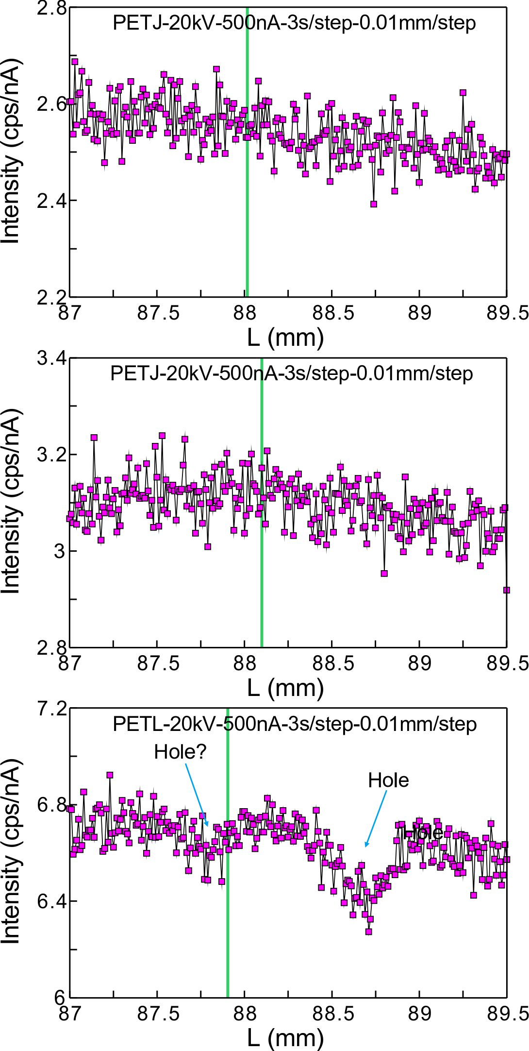

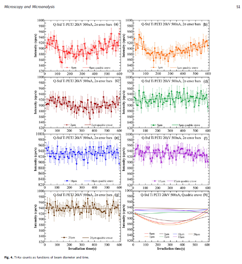

Here's fig 4 from the Cui et al (2018) M&M paper attached in the previous post:
showing TDI effects for a 500nA beam from 0 um to 20 um.  Only the 0, 1 and 2 um beam sizes show significant changes in intensity over time. What I find quite interesting is that the intensities at first decrease over time (~300 sec), but then increase back up after another 300 sec or so.
I've seen almost every type of trend in TDI plots so this could be quite real, but I have to wonder if the beam or stage could have drifted slightly over time with these very focused beam spots, and then eventually started hitting some undamaged areas around the original beam incident spot causing an apparent increase in intensity after the initial decrease in intensity.
Has anyone made similar measurements that they can speak to?

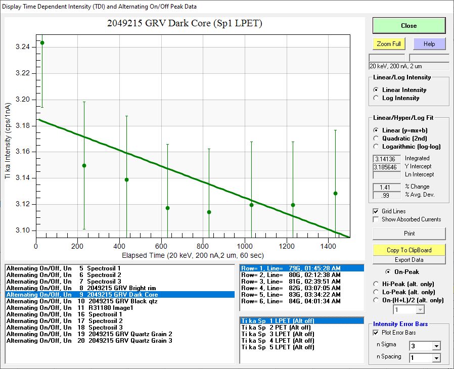

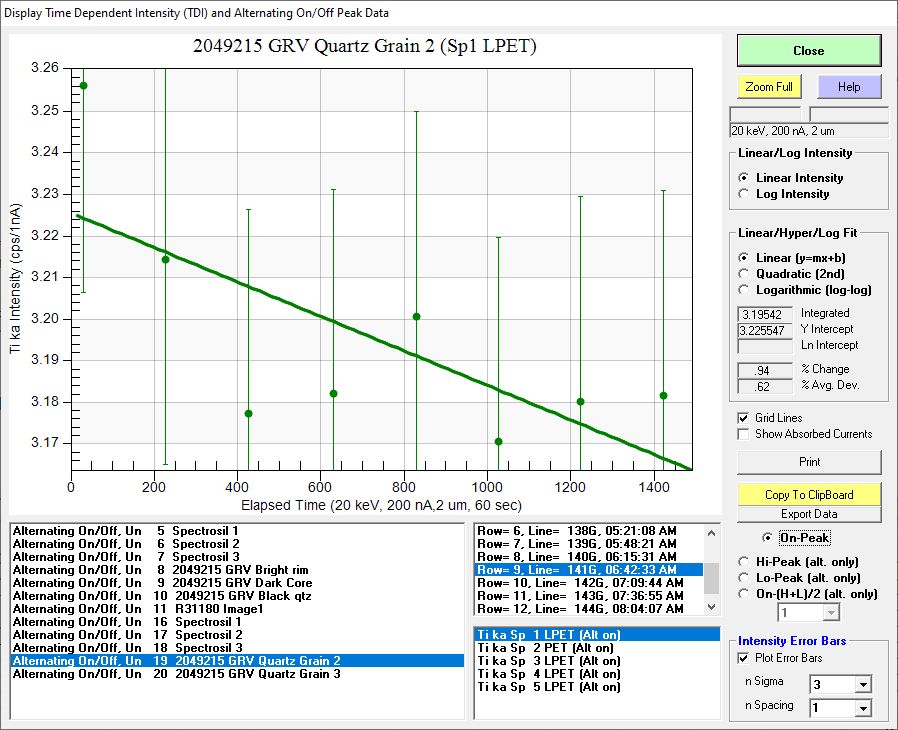

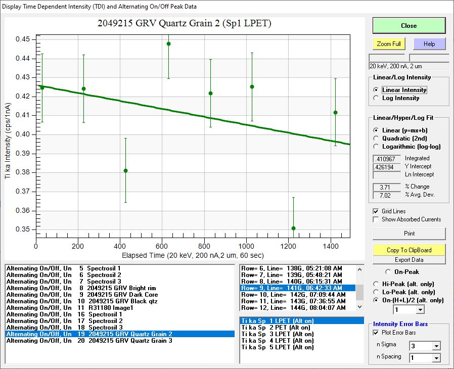

BenjaminWade
  • Professor
  • Posts: 199
Re: Ti in Quartz (without PFE)
« Reply #4 on: March 19, 2019, 10:52:18 PM »
Hi John

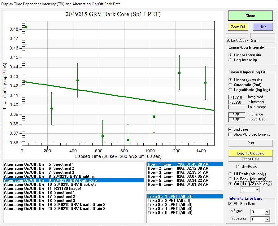

I don't have any for 0 or 1 um or beam currents that high, but some measurements at 2um and 200nA. My alternating On/Off peak number is a lot coarser than in the documented study though so hard to compare. Also my total counting was for more than double the time. On a gross scale though all of my analyses at 2um display and initial sharp decrease in the first couple of minutes followed by a flattening out/slow decline. Some examples below of On-Peak and corresponding -bkgd.
« Last Edit: April 13, 2020, 08:43:00 PM by BenjaminWade »

This is interesting that you did not see the decrease, then increase in Ti intensities that the Cui et al. (2018) paper reported.  And your measurements were over a longer time span.  Your results seem more intuitive to me that sample damage would decrease intensities over time and level off eventually. This makes me suspect that they were actually observing beam or stage drift into undamaged adjacent areas of the sample.

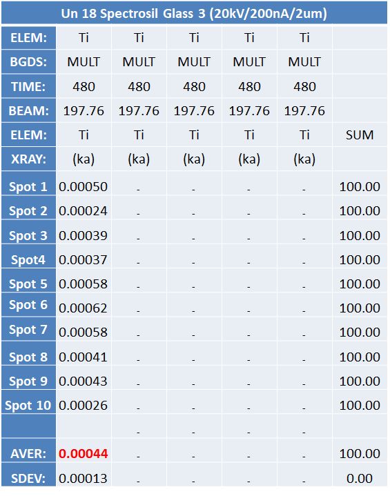

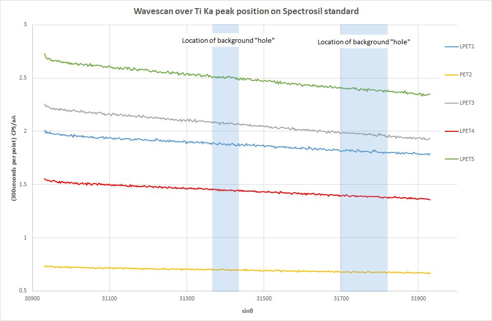

Here are wavescans done on my Spectrosil glass at 200nA/300s count time per point. If the holes are there they are not obvious.

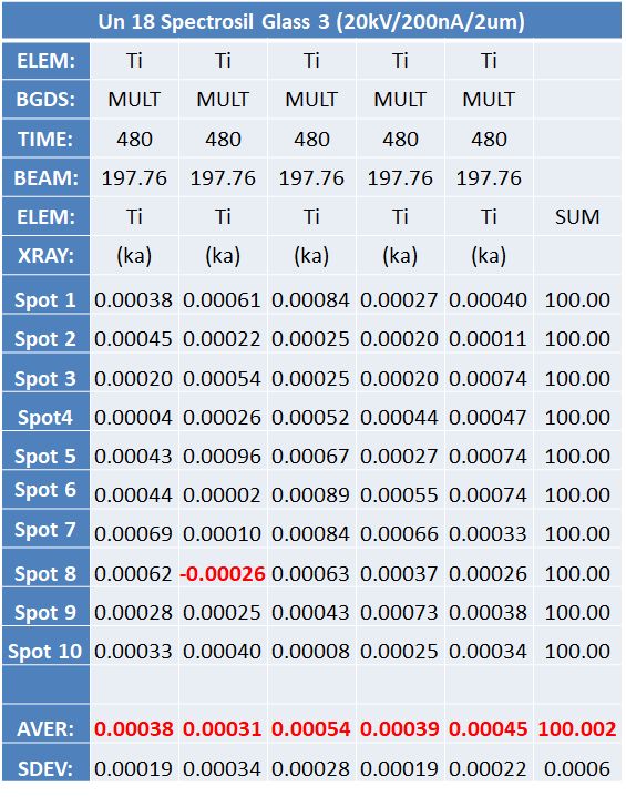

With regards to the actual analyses at the time, here are some screen captures of a presentation I gave at the time, of my analyses on my Spectrosil Glass #3 (3.94+/-0.33PPM Ti - LA-ICPMS):
Data with no blank correction or aggregation
Data WITH blank correction using a different Spectrosil Glass, and NO aggregation
Data WITH blank correction and aggregation
Perhaps one could argue that its circular using a Spectrosil glass to blank correct a different spectrosil glass (despite them having different Ti concentrations). I didn't have the Hot Springs quartz at the time so should repeat the experiment. I did analyse some other real samples which had Ti concs down to 10ppm or so which matched well with subsequent LA-ICP-MS studies on it.
« Last Edit: April 13, 2020, 09:10:17 PM by BenjaminWade »

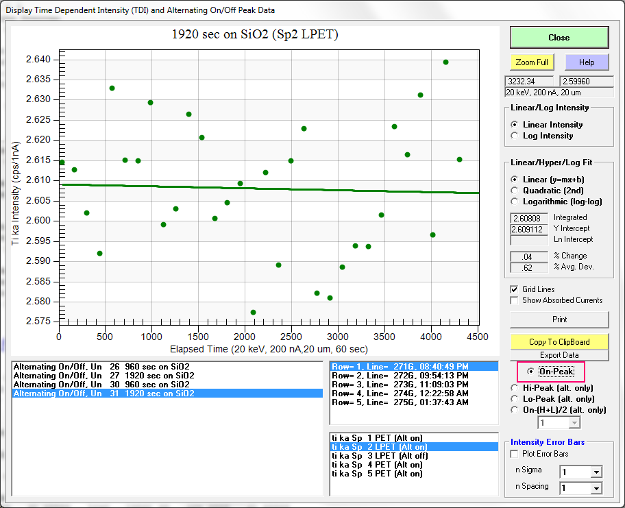

« Reply #7 on: March 21, 2019, 09:29:11 AM »
Hi Ben,
All I wanted to see was this line below from the log window output (highlighted in red):
ELEM:       Ti      Ti      Ti      Ti      Ti      Si       O   SUM
XRAY:     (ka)    (ka)    (ka)    (ka)    (ka)      ()      ()
   271 -.00003  .00039  .00003 -.00006  .00051 46.7430 53.2576 100.001
   272  .00010  .00039  .00022 -.00036 -.00030 46.7430 53.2570 100.000
   273  .00003  .00037  .00008  .00007  .00048 46.7430 53.2577 100.002
   274  .00002  .00016  .00015 -.00005  .00009 46.7430 53.2572 100.001
   275 -.00010  .00019 -.00002  .00016  .00009 46.7430 53.2572 100.001
AVER:   .00000  .00030  .00009 -.00005  .00017  46.743  53.257 100.001
SDEV:   .00007  .00011  .00010  .00020  .00034    .000    .000  .00067
SERR:   .00003  .00005  .00004  .00009  .00015  .00000  .00012
%RSD:  4057.70 37.3350 103.073 -404.32 193.525  .00000  .00050
STDS:      922     922     922     922     922     ---     ---
STKF:    .5621   .5621   .5621   .5621   .5621     ---     ---
STCT:   667.34 1600.07 1901.70  531.93  828.32     ---     ---
UNKF:    .0000   .0000   .0000   .0000   .0000     ---     ---
UNCT:      .00     .01     .00     .00     .00     ---     ---
UNBG:      .99    2.63    3.41     .79    1.38     ---     ---
ZCOR:   1.1969  1.1969  1.1969  1.1969  1.1969     ---     ---
KRAW:   .00000  .00000  .00000  .00000  .00000     ---     ---
PKBG:  1.00002 1.00271 1.00077  .99951 1.00155     ---     ---
BLNK#:      27      27      27      27      27     ---     ---
BLNKL: .000142 .000142 .000142 .000142 .000142     ---     ---
BLNKV: .000000 -.00125 -.00272 .000689 -.00040     ---     ---
The "blank level" indicates the size of the blank correction relative to the specified blank value in the blank standard (usually zero for a pure synthetic SiO2 glass such as Spectrosil, but is 0.000142 (1.42 PPM) in my synthetic quartz from ICP-MS). For those that haven't utilized the blank correction in Probe for EPMA, the blank standard is run as an unknown to keep the conditions the same as your other unknowns.
So looking at the last line we have for my 5 spectrometers:
ELEM:    ti ka   ti ka   ti ka   ti ka   ti ka   BEAM1
BGD:       OFF     OFF     OFF     OFF     OFF
SPEC:        1       2       3       4       5
CRYST:     PET    LPET    LPET     PET     PET
Or in PPM:
BLNKV:       0   -12.5   -27.2    6.89      -4     ---     ---
So the three normal sized crystals have blank corrections in the zero to 7 PPM range while the two large area crystals have *negative* blank corrections of 12.5 and 27.2 PPM.  These negative blank corrections are due to the "holes" in the continuum that I only see in my two large area LPET crystals.
You said you only used a wavescan counting time of 30 seconds (at 200nA?), so you would definitely have trouble seeing the blank corrections in the range of a few PPM as you showed in your presentation slides.
Please post the BLNKV: line from the log output and then we'll be comparing apples to apples.

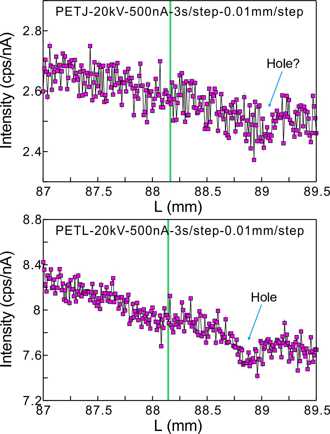

It seems that there are still some shortcomings in our paper, however, I am glad to join the discussion. For a “hole” in the PET crystal, we did some wavescans in other two JEOL EPMA instruments last year, with 3s/step and 0.01mm/step. We found that the hole is visible in large PET crystal, but not obvious in normal PET crystals. It seems that the hole is related to crystal size, or related to the Johanson type crystal or Johan type crystal (I am confused that the JEOL PETJ crystal is a Johanson type or a Johan type). I will repeat the wavescans with long enough dwell times, and also repeat the wavescans in SHIMADZU EPMA instruments (The crystals in SHIMADZU EPMA are all Johanson type).
The wavescans in first JEOL EPMA instrument (the green line is the Ti Ka peak position):
The wavescans in second JEOL EPMA instrument (the green line is the Ti Ka peak position):
For the TDI effects of Ti, based on Ben’s measurements, I now also suspect that we were actually observing beam or stage drift into undamaged adjacent areas of the quartz. However, I am just curious that if that is the case, the Al Ka intensities would at first increase and then decrease, since the TDI of Al and Ti were carried out at the same point and same time. We will repeat the TDI measurements in our lab and other labs.
« Last Edit: March 23, 2019, 08:00:10 PM by Shui-Yuan Yang »

Your paper is excellent, in fact you beat us to publication on the trace element TDI effect. Annette von der Handt and I have been recently writing up this trace element TDI effect, but you got it published first, so good for you!
Also, that is very interesting that you only find the hole in the continuum for Ti Ka with the large area PET crystal. You should post an example when you get a chance. Do you also see two holes, a smaller one right under the peak and another larger one just to the side?  We had to count 300 seconds per wavescan point to see these.
Edit: now that I see your in-line images, it does appear that you have two holes possibly. And just as in my scans, the smaller hole is directly under the Ti Ka peak, and the larger hole is to the right as seen here:
« Last Edit: March 23, 2019, 09:48:56 PM by Probeman »

« Reply #10 on: March 24, 2019, 12:02:10 AM »
I think it might have two holes for the large PET crystals in our wavescans. We did the wavescans on the quartz from SPI standards. The holes directly under the Ti Ka peak is not obvious possibly due to the "not pure" property of the SPI quartz.
We did the wavescans on a synthetic SiO2 glass and a purified quartz, but we observed the obvious Ti Ka peaks. Finally, we found that the Ti Ka peak of quartz from SPI standards was not obvious and then we did the wavescans on SPI quartz to observe the holes. We will try to get some Spectrosil glass material and repeat the wavescans with longer dwell times.

My apologies I misunderstood. Here are my values:
              LPET(LP)        PET       LPET(HP)      LPET(LP)     LPET(HP)
BLNKL:    .000470     .000470    .000470       .000470      .000470
BLNKV:    .000093    .000135     -.00019       .000238       .000015
There is no obvious correlation between small vs large xtal and negative blank correction.
My spectrosil quartz isn't as pure as your synthetic quartz material (4.7 ppm). The analyses were done on another spectrosil sample (3.9ppm), so I am not sure how much of an effect using a blank standard which has more Ti in it than the sample you are analysing would have?
