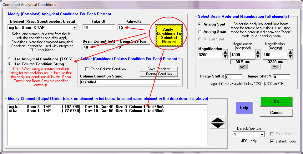

Ok, I understand. Then still, even for the kV, the nA for documentation or necessary: If I open the dialog, and I set a column string AND nA, why wouldn't it remember the two? It is much more convenient that in remembers what you change.
Would it be possible to change this behaviour?
I think so, let me look at it.

Hi Philipp,
I may not be understanding you properly, but it appears that the software does exactly want you want it to do...
That is, when you click the Apply Conditions To Selected Elements, it saves all conditions and the column condition file as you suggest...
Maybe you forgot to click this button?

Strange. I swear, I programmed today 48 lines and it did not work. What I did: I opened the dialogue, I changed the beam current to 250, then I clicked "browse", I selected my file, I pressed "apply" and it applied the file, but not the nA. I will try again tomorrow. Did you try without setting kV? Otherwise the dialogue looks exactly like mine.
Another question: Is the image shift saved in the pcc file? Or do I have to set it in the same dialogue, or both?
And the red text warns about "beam current" as well, that's why I tried to set it.
Thanks for looking into this!
Ok, I see the confusion. Yes, just selecting the column condition file does not load the beam current automatically. You have to enter the keV, beam current, beam size yourself manually, but, it will save everything you specified.
The confusion was caused by me mentioning that I have some code which *tries* to load these analytical parameters from the column condition file, but it was originally designed to handle a situation (Cameca SX50), where the column condition file is in the instrument memory and can't be read and parsed easily. It gets more complicated, but that is the general issue.
Yes, image shift is saved to the column condition files, that is one of the main uses for this feature.  I also think you can specify different image shifts for different keVs in the Automate! Conditions button for use with the Digitized Conditions automation basis.

Hi John, I think I did not express myself correctly. I should be more clear in what I am saying. Sorry. I try again:
What I did: I opened the dialogue, I typed in the beam current 250 into the Beam Current field , then I clicked "browse", I selected my file, I pressed "apply" and it remembered the file , but the beam current was given in the channel list as 20 nA. I opened the channel again, and the beam current in the field was written 20 nA, so not remembered. I typed in 250 into the Beam Current Field, selected "apply" and now I saw in the channel list (and also when reopening the channel) that it had saved 250. So I had to edit the channel twice to get both settings saved. Does that make more sense?
Do I understand correctly: On the right is a dialogue about "Select beam mode and..." where I can set the image shift. In your example this is set to 0 and 0. Is this overridden then by loading the column string?
Is it correct that the SX50 is not supported any more by the V10 of PfE? Maybe then it would be better to change the wording "column string" into "column conditions file" or something? Or is it still valid for the Jeol?
I would click the column condition file first, then edit the analytical condition fields if necessary. Then click Apply.... why?  Because the browse/selection of the column condition file might update the analytical condition fields, if they have been specified before and therefore they might need to be updated manually.  Remember, in combined conditions mode each element can have a separate set of conditions.
Yes, the image shifts are overwritten by the column condition file and are there for "documentation" purposes just like the beam current, etc. when running in column condition mode.
Yes, the SX50 is no longer supported in v 10 of the software, and yes, I will be moving more in that direction to clean up remnants from older instruments ASAP.

Ok, so, it works, if I choose the file first, and then type the 250 nA.
When I type 250 nA first, then choose a file, it sets the field back to 20 nA.
So the order of doing things matter.
