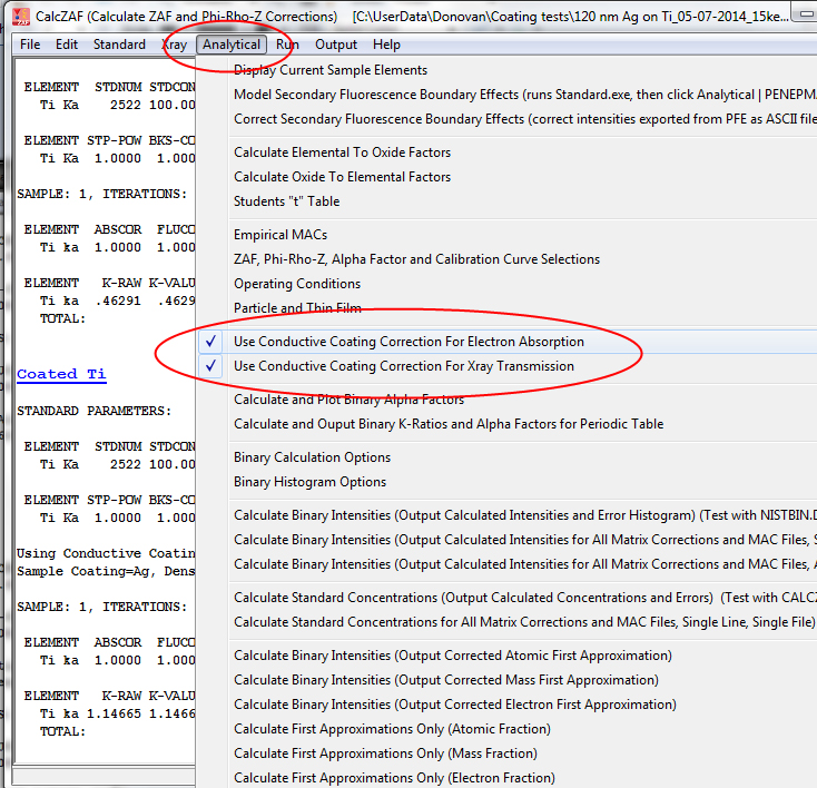

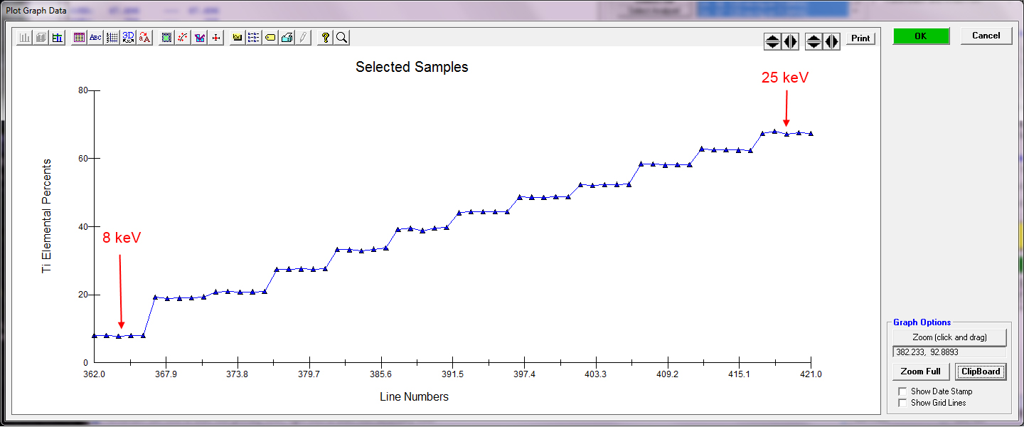

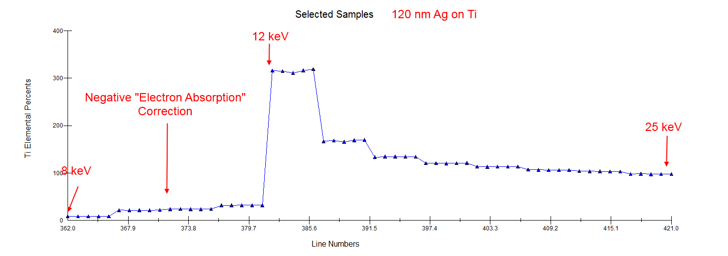

This coating correction gives excellent results for most typical coating situations even when the standard and unknown are coated with very different materials. Unfortunately the calculated ratio starts to become inaccurate as the overvoltage falls and finally goes negative with excessively thick coatings (or very low beam energies) as seen in this graph of a Ti metal sample coated with 120 nm of Ag for a range of incident beam energies from 8 to 25 keV:
![](https://probesoftware.com/smf/oldpics/i57.tinypic.com/255uzpj.jpg)
I would be interested if anyone has a more sophisticated expression for dealing with the "electron absorption" effect in very thick coatings.
