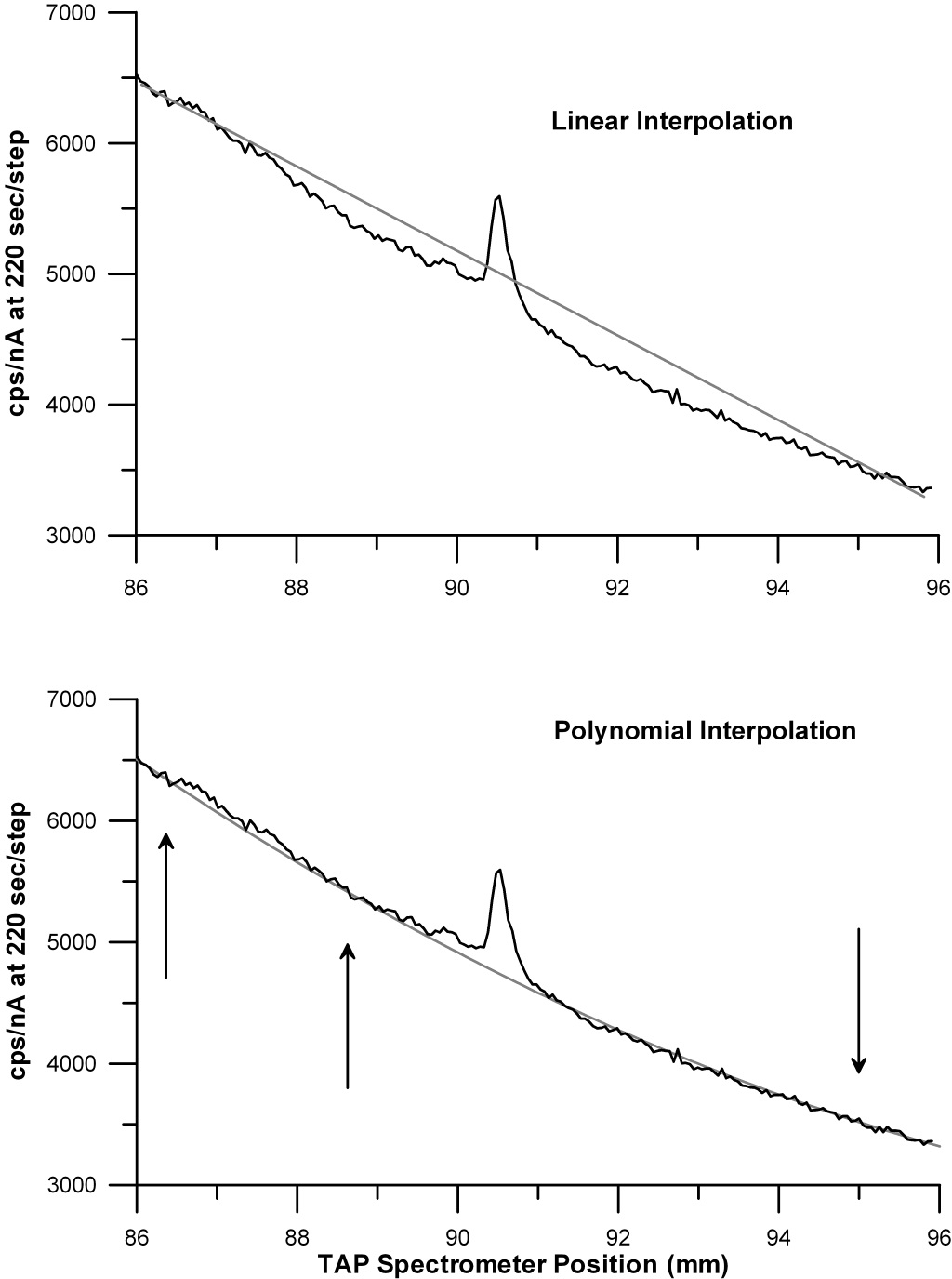

For those who aren't familiar with the MAN method it may be interesting to appreciate that the MAN method often gives very slightly higher concentrations for trace elements in complex samples.  This is usually due to subtle off-peak interferences. Which of course the MAN method completely avoids because it doesn't measure off-peak backgrounds (unless of course one is utilizing the off-peak interpolated MAN method as originally suggested by Ben Hanson at Dow Corning):
http://probesoftware.com/smf/index.php?topic=987.msg6455#msg6455
In simple matrices where there are no signifcant off-peak interferences, the MAN and off-peak methods are usually within statistics.  Unless of course there is a curvature to the continuum in that region of the spectrometer as shown here in a figure from my Amer. Min 2011 paper:
Here's how I usually explain why off-peak measurements sometimes produce lower trace concentrations to my students:  generally the highest average peak intensity and lowest average background intensity is what we would consider most representative of the "true" net intensity. This is because one can usually only lose photons in the peak measurement (by not being quite on-peak), and one can generally only gain photons in the bgd measurement (by having off-peak interferences).
So finding the highest peak intensity and the lowest background is generally the goal. Of course this is just a "rule of thumb" as in the real world there are also sample and detector absorption edges, holes in the continuum and other continuum artifacts.  But the cool thing about the MAN background method is that it doesn't care about any of the off-peak interferences or continuum artifacts because one is always measuring *at* the on-peak position only!   8)
